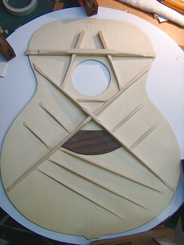

Yikes Martin ! If you are to scallop at all , start well past the bridge . I've chosen to use tapered bracing for my 12 with the parabolic type shape. Here's a pic of mine
Hope this helps
Cheers Craig

Martin...I'm searching from memory here as to the key points others have stated when designing bracing for a 12 string. Here are some items I remember:
...5/16" X-bracing scallopped similarly to that of a 6 string...voice accordingly but err on the side of heavier bracing. Some have stated that their 12 string bracing departs little from 6 string.
...1/4" tone bars...some have added a 3rd tone bar (like Craig) but I've seen a lot with only 2
...Slightly thicker top...yours sounds like a good start depending on thickness.
Hopefully this will generate some comments from others who know more.
BTW...I commend you for speaking up on this before gluing that top to the sides...you must have had a sense that it might be a potential bomb.

Appreciate your opinion Lance .It's an Englemann top and fairly light . I have the box closed now and am getting a G# from the top ,without bridge . It seems quite responsive and ( was ) fairly happy with it.
The lowest tonebar is only 5 m.m. and the rest have had been carved away till they are quite thin .As this is my first 12 string , I had advice from a very experienced builder here in Australia ,who has built many successful 12's, He emphasized a large bridge patch and not to scallop.
Where do you think I should lighten up ?

Surgery is nearly complete...Ive gone for a tapered cross brace and three tone bars as on Craig's instrument.
PostPosted: Wed Sep 05, 2007 10:01 am
Posts: 720
On ya Martin .You'll sleep better at night
Another thing I was advised was to locate the first tonebar up close to the bridge patch , and have it angled so that the end of it almost intersects the crossbrace at it's end.
I note Taylor and others do this also.
Cheers, Craig
